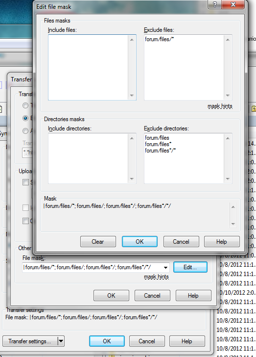

I'm running WinSCP 5.1.0 (Build 2625) on Windows 7 64-bit.
On a synchronization between local folders and a server I am trying to get it to ignore the directory "forum/files/", as in I don't want it to sync any files or folders that are in that directory. I have tried adding these filters to the file mask but it doesn't seem to be working:
| forum/files/*; forum/files/; forum/files*/; forum/files*/*/
Can someone please help me find the correct file mask to exclude "forum/files/" from synchronization?

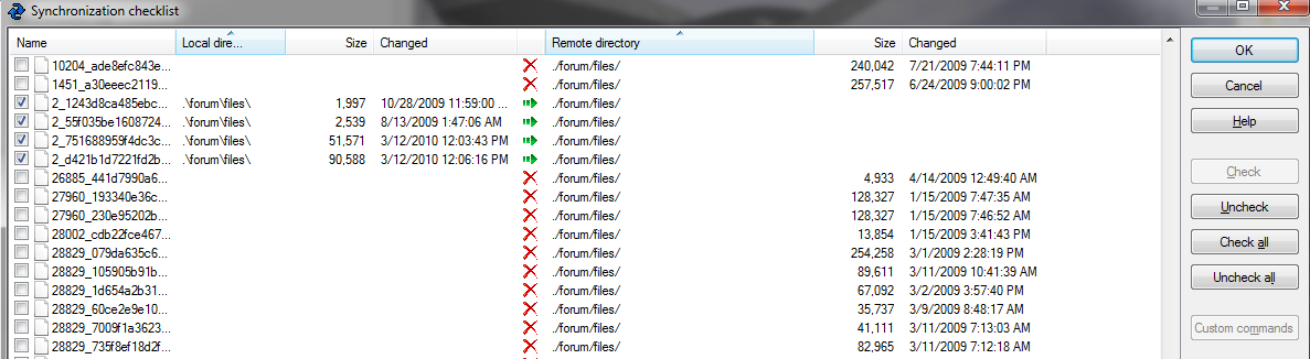

Description: The synchronization preview window which is still putting checkmarks next to files in the folder I'm trying to ignore.
Description: The exclusion file mask filters I'm trying.
