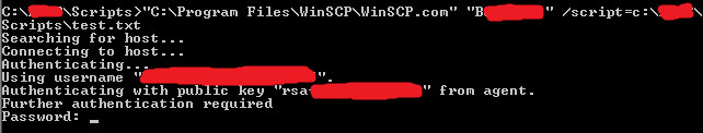

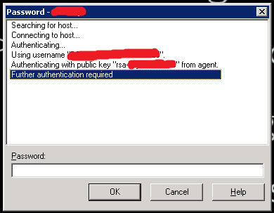

For this second site, we store the private key in Pageant and that authenticates fine. After that step, it asks for a second password while displaying the message "Further authentication required" (as per attachment 1.png). If I type the password into the GUI it works fine. The second password is a requirement of the people we are connecting to.

When I run this, I get the message in attachment 2.png. Again, if I type in this password it connects.
