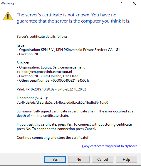

Hi there,
we have a situation where a certificate chain isn't trusted. From what I got WinSCP should be using the Windows certificate store.
We have imported the root CA (it's not in there already), but this doesn't alleviate the issue.
WinSCP states that there's a self-signed certificate in the chain at depth 4. Root CA certificates are always self-signed, so I don't consider that to be the real issue. The real issue probably is it doesn't actually trust the root CA certificate.
With OpenSSL we can see it presents the root, 2 intermediates and the end certificate. OpenSSL verifies it just fine if we supply the root certificate as evidenced here:
/tmp $ openssl s_client -connect cs-bedrijven.procesinfrastructuur.nl:21 -starttls ftp -showcerts -CAfile /tmp/root.crt -verify 5
verify depth is 5
CONNECTED(00000003)
depth=3 C = NL, O = Staat der Nederlanden, CN = Staat der Nederlanden Private Root CA - G1
verify return:1
depth=2 C = NL, O = Staat der Nederlanden, CN = Staat der Nederlanden Private Services CA - G1
verify return:1
depth=1 C = NL, O = KPN B.V., CN = KPN PKIoverheid Private Services CA - G1
verify return:1
depth=0 C = NL, ST = Zuid-Holland, L = Den Haag, O = Logius, OU = Servicemanagement, serialNumber = 00000004003214345001, CN = cs-bedrijven.procesinfrastructuur.nl
verify return:1
Certificate chain
0 s:C = NL, ST = Zuid-Holland, L = Den Haag, O = Logius, OU = Servicemanagement, serialNumber = 00000004003214345001, CN = cs-bedrijven.procesinfrastructuur.nl
i:C = NL, O = KPN B.V., CN = KPN PKIoverheid Private Services CA - G1

220 Welcome to cs-bedrijven.procesinfrastructuur.nl OTPi environment
^C
The server is publically availabe so you should be able to test by importing the latest cert in the OpenSSL output into the root store.
Tested with both the latest stable version and 5.16.1 beta.
verify depth is 5
CONNECTED(00000003)
verify return:1
verify return:1
verify return:1
verify return:1
Certificate chain
^C
