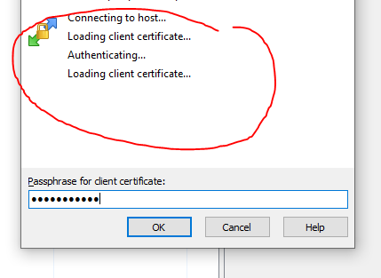

Just another irregularity I noticed during testing:
On the initial login WinSCP asks three times (!) for a password. First for the (1) certificate password then for the (2) user password and finally again (3) for the certificate password. This issue seems to be related to the 2-step authentication method of the server and may help on analyzing.
Just for your interest, other WebDAV clients (like CarotDAV) does work very well with our servers. There have been no issues so far.
Just WinSCP is failing with larger file transfers.
But since WinSCP has the best user interface it would be great to have this issues fixed.

After further debugging on our side we found a way to improve the 2-step authentication process (particularly the handling of the re-negotiation requests).
With this new authentication method WinSCP does not fail anymore and does not shown the SSL handshake failures anymore.
So it looks as this issue is a non-issue for the time being. ;-)
Thanks for your answers and support!
By introducing a session variable we can avoid now that the client needs to expose the certificate twice in the 2nd authentication step (after re-negotiation).
