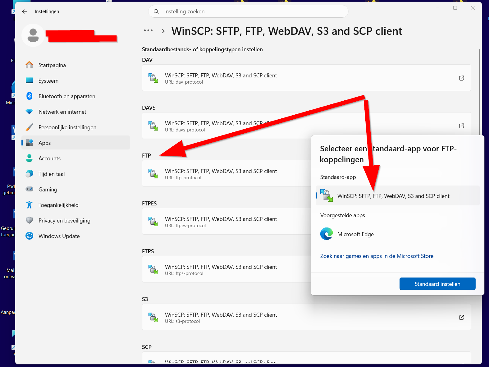

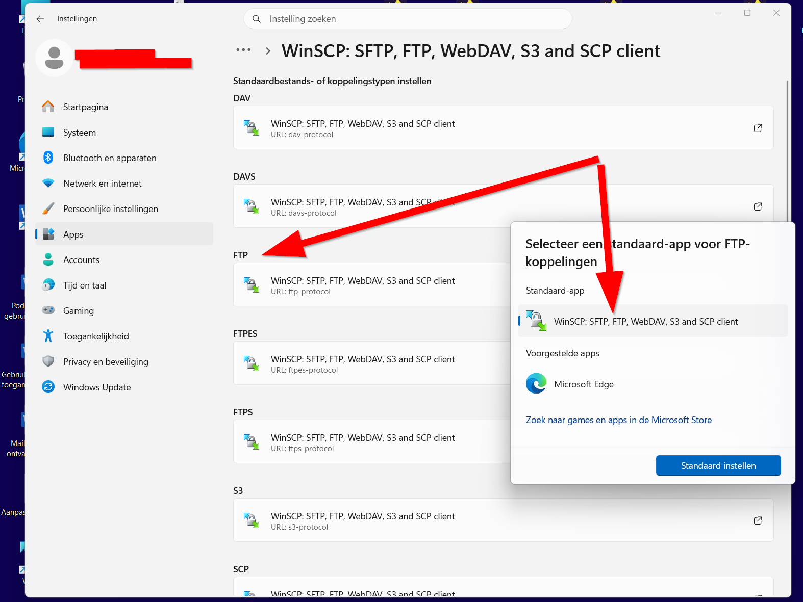

WouterNL
9
Installer instead of client
You are right, because when I check the UAC pop-up, it shows me the WinSCP installer.
But when I try to change the default app, I cannot see if it is the installer or the normal client.
The screenshot is in Dutch, but I think you can understand what I mean when I choose FTP, and that it is not possible to select a different kind of this app.
How can I select the correct app instead of the installer?
Description: Screenshot

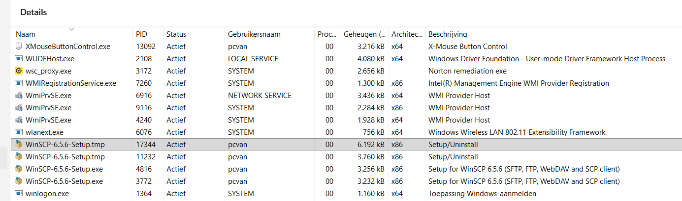

When you click on the URL and WinSCP installer starts – please go to Task Manager's Details page, show Command line column, locate all WinSCP and WinSCP installer processes and post their commandline.
Btw, did you try reinstalling WinSCP?
Thanks for the screenshot. But you haven't shown the Command line column (right click the list header and choose Select columns).
WouterNL
9
Screenshot with command lines
For security, I've checked the private option for the attachments.
  • WinSCP-Commandline.png (38.3 KB, Private file)
